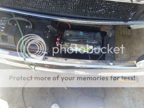

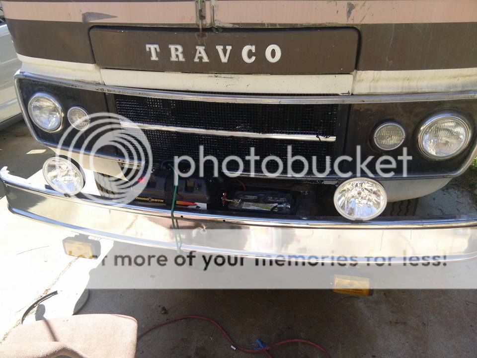

Also going to add a new starting battery, The run from the generator battery is longer than I like and I have that compartment in the front bumper That looks like it was a battery tray. The local county Chamber of Commerce is having a fund raising cruise-in in June and I think we will roll an Unfinished Nessie in. First camping trip is in April, Second in May, a third in July. and a fourth in September and a fifth planned for November over Thanksgiving. All the time inbetween will be working on getting things finished.

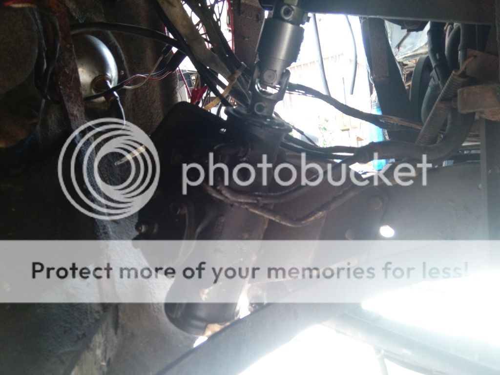

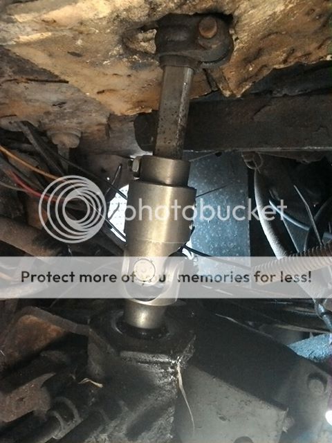

It is an universal joint/ vibration damper that replaces the factory pot joint in the steering shaft.\n\nImage\nDodge pot joint for steering linkage\n\nImage\nBorgenson joint in a Travco\n\nborgeson part number 034940 is the right one for the Travco.

\n\nWhat you have there is a factory pot joint like in the first picture. It only looks different because it is a breakdown. The second picture I posted is the borgeson. The borgeson uses a U-joint where the pot joint uses lots of little pieces to make the bend,

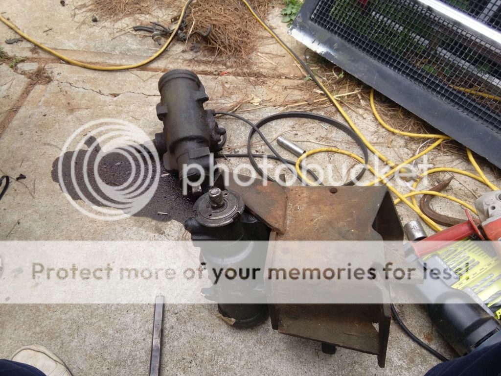

Nice day today. Pulled the steering box out with its mounting bracket. Discovered I either have to buy a shaft for the borgeson joint or cut the old shaft off at the pot joint. I dont have any cutting wheels at the house so that did not happen. I needed to run out and get a ball joint fork to get the drag link loose from the pitman arm. On the way home from Advance where I got the tool my Subarus Alternator decided to quit charging. I figured no big deal I have a spare at the house and I can change it when I get some time. Went to move my truck and it wouldn't start. No spark, damn I was going to let the subaru sit and use my truck for work. Pull off the travco to change the alternator on the roo and it is fixed. The new steering box for the travco is bolted up to its bracket and the pitman arm is back on. the bracket is still on the driveway. Did a little troubleshooting on the truck and either the coil or the ignition module. Someone used a GM ignition module on My old Dodge truck and I was going to go back to the factory ignition but decided today was not the day with the way my luck was running. Have to be in work early tomorrow so I stopped until I figure out what to do with the new joint and the steering shaft.

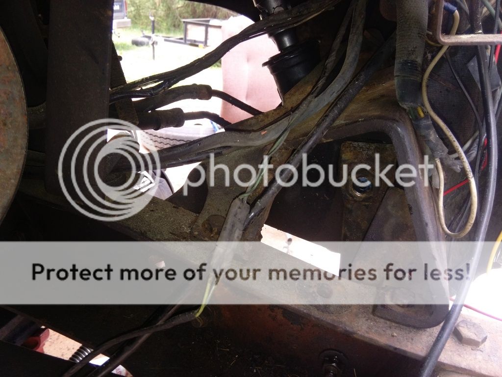

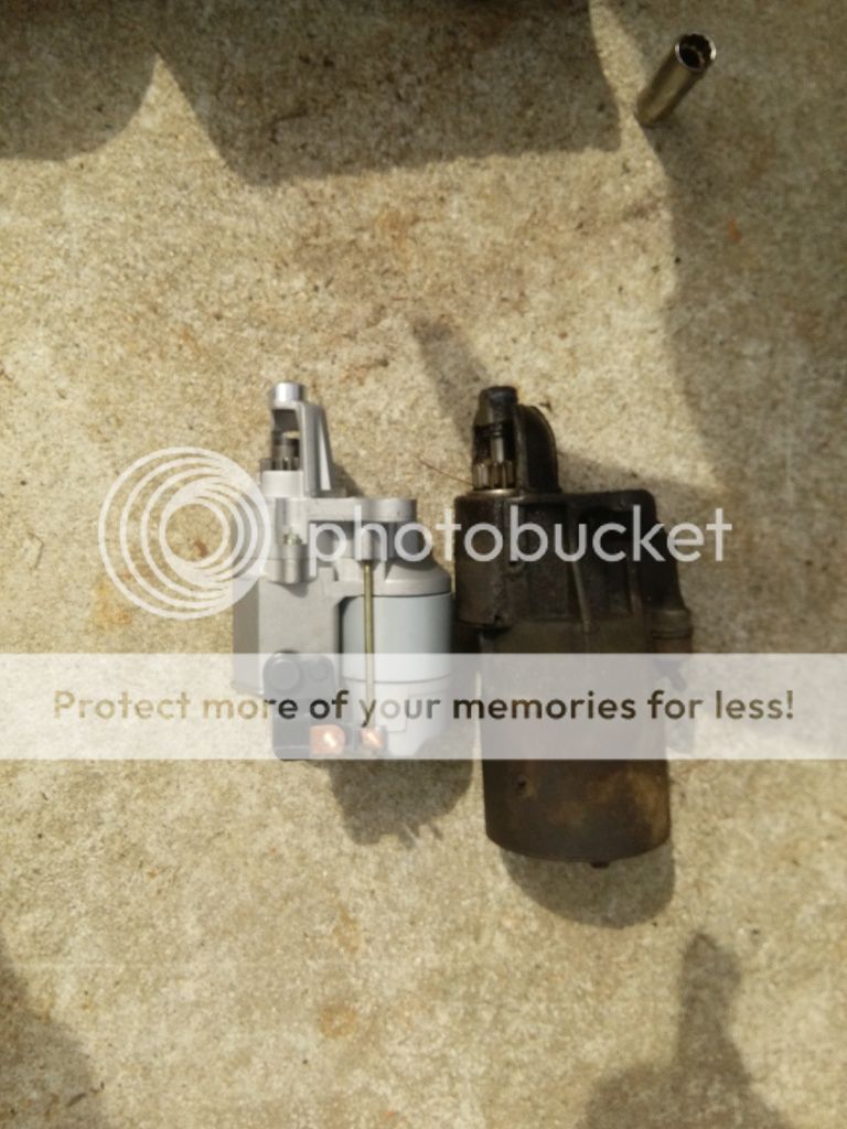

Today was a productive day. New steering box is in with the Borgeson joint. Finally got that left header loose for a gasket change. I need to order some header bolts to get it back together. Took advantage of the header being out to replace the old monster starter with a High torque Mini starter. Old starter cable was a hair too short but in my parts bin was a Subaru Outback starter cable that worked well. Tomorrow will be cleaning the header flange, replacing the right front shock, and putting the radiator back in. (easiest way to get to the steering box mounts bolts was through the grill. \n\nImage\n\nImage\n\nImage
