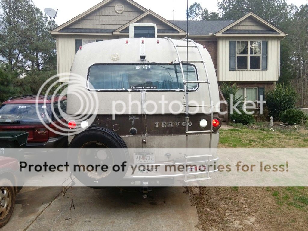

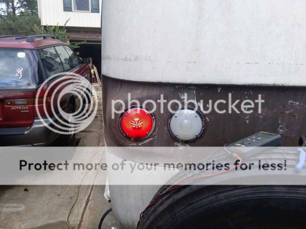

PO installed all 4 red across the back. All 4 are 1157 (high/low) but the inside lights are just wired to running lights. \n\nI *think* I solved my strange turn signal/brake light issues by ordering a new turn signal assembly. \n\nI will replace all the rears with new LED roundies and probably wire them all up as the same per side. Both rights will be brake/turn/running.\n\nSince someone butchered the wiring and deleted the reverse lights, I will probably add a relay setup and some nice bright LEDS under the rear bumper or wherever so I can actually SEE when I am backing up. I found the 75 wiring schematic and can find the reverse signal wire off the NSS. Will go from there.
