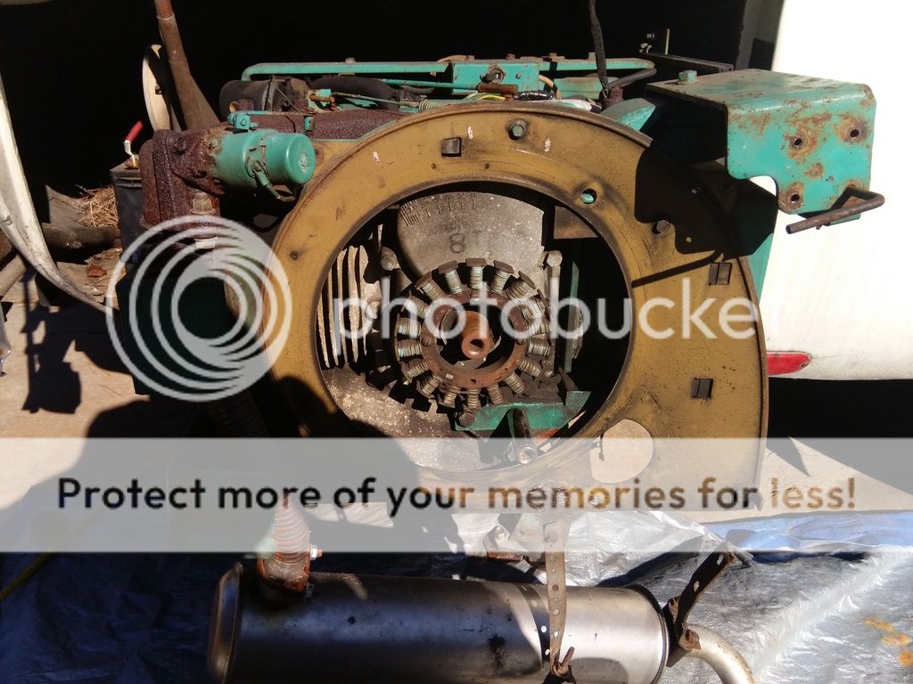

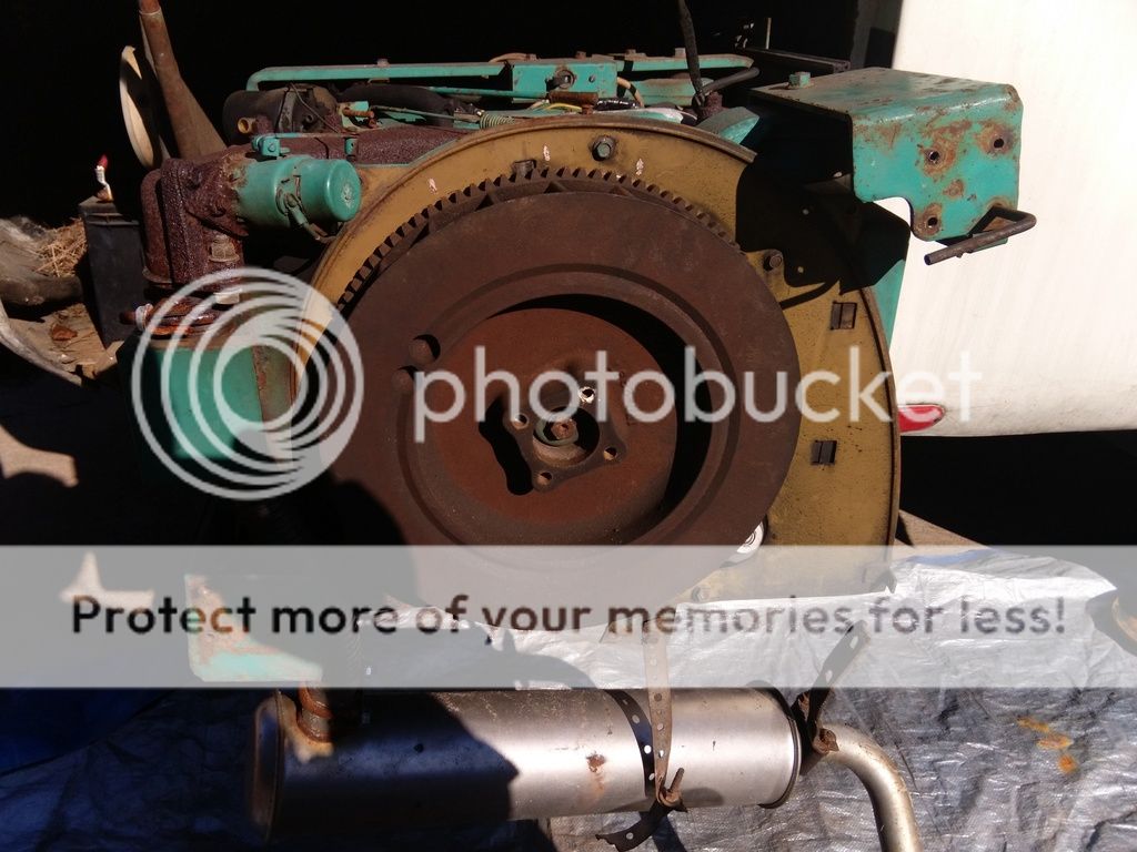

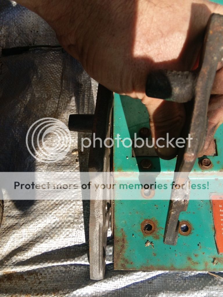

New and old brackets. New one is thicker.\nImage\nImage\nImage

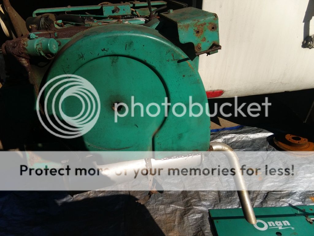

Fun to get to.\nImage\nImage\nImage

Generator is up and running. Exercising it right now. The old bracket seemed to allow starter movement when cranking. No movement at all with the new bracket.

\nIt is time consuming but not really difficult to do. You do need a puller and torque wrench for the flywheel. everything else is 1/4 20 bolts with 3/8" heads.
