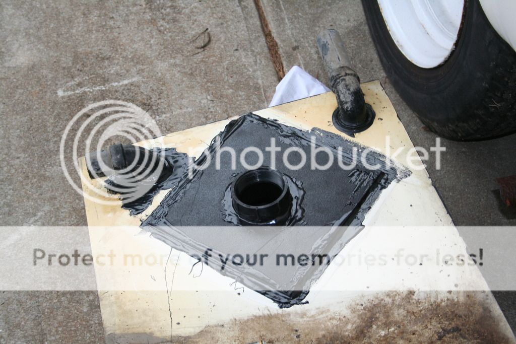

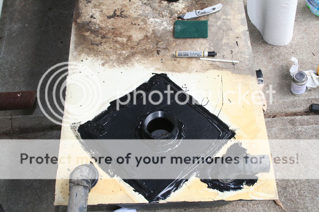

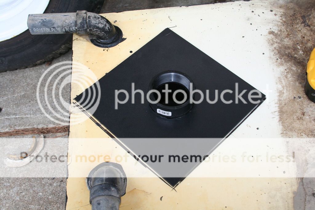

Unread post by KB2CRK » Tue Mar 10, 2015 5:32 pm
Well I finally dropped the tank and used the plastimend. The fitting for the kitchen drain was also broken loose so that got repaired also. The Plastimend worked great. As soon as it is fully cured I will reinstall the tank. I need to pick up a couple fernco couplings to tie the kitchen and bathroom sink line back in.\nImage\nImage\nImage\nImage\nImage
